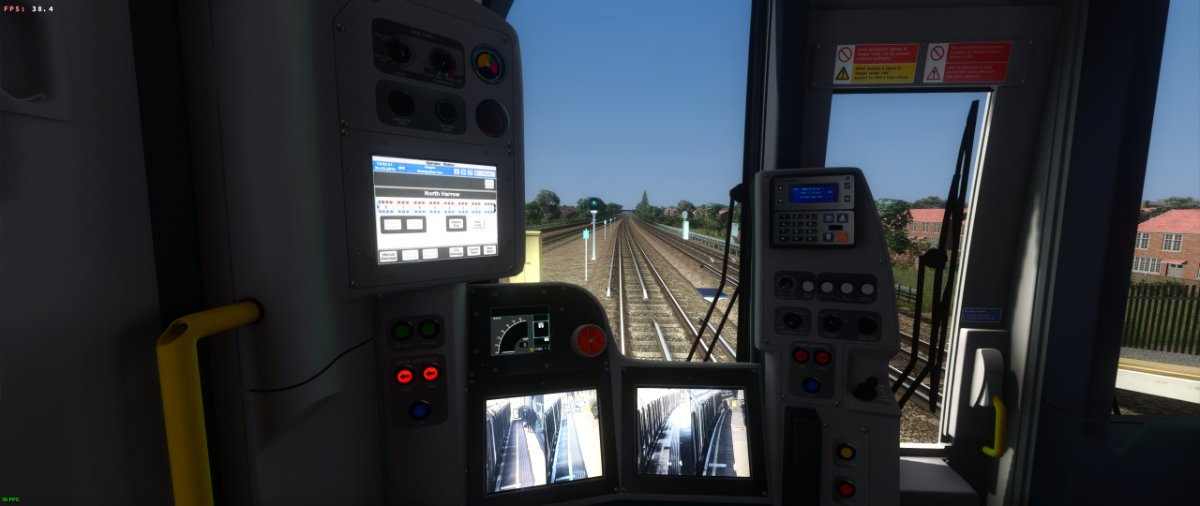

I have now played for a bit using DXVK and borderless your way and my image quality is much much better than when I was editing the PlayerProfiles.bin those extra few pixels (see my earlier post for the max I could set it) that I get doing it your way seem to make all the difference.
I now have everything set on max, Anti_Aliasing was always on FXAA + 3 x 2 SSAA now I have it on FXAA + 3 x 3 SSAA, Shadow Quality slider used to be on about 45% now it's at 100%, Water Quality I always have on 1 notch below full because I think the water looks better at that setting anyway.
On the next page Ambient Occlusion was off but now I'm trying it on high, might put it on dynamic just to try that later too.
So, on the JT Met Line I'm now getting around 40 FPS whereas I was getting 26 to 30 as I mentioned before, unbelievable difference and tbh I didn't really even miss my DSR x 2.

Still get slight issues with my mouse cursor not appearing but I've figured a workaround for now, when I first load it up and get to the menu I Alt + Tab and bring forward any other program to get my cursor to briefly show so I can position it over the button I wish to press, of course once I left click the focus returns to TS and I lose the cursor again but I can rinse and repeat the process until it loads in the scenario I want (which proves the stability of the DXVK because even though I Alt + Tab multiple times whilst setting up my drive I've not yet had a ctd or oom), and here's the thing, once RWE2 comes into play on the scenario and the overlay pops up I get (and keep) my mouse cursor for the duration of my scenario. Huzzah! 🥳👍
